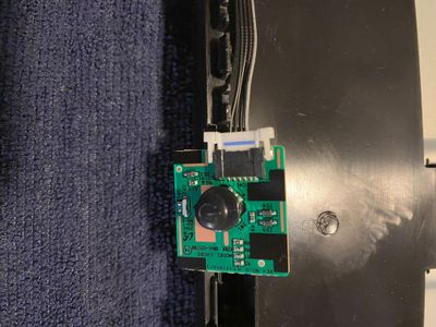

[Update: Just realized I did a similar post last year April 🙂 Sorry! But new pictures here!]
Honestly, the only thing that worked for me was to replace the joystick entirely. Below are some pictures which show that the original design is already flawed. That plus the recessed installation in this monitors frame makes it extremely susceptible to wear. The "whack it a couple of times" "Fix" only makes things worse.
The small metal connectors get dislodged over time making connections depend more on luck than anything else.
I replaced mine about 18 months ago and attached it outside the frame for easy access and hopefully longer life. But still it starts to show first signs of disconnects. I have another replacement, let's see when I need to use that one.

Can you explain how to do this? Like what parts to get and if theres anything going on besides desoldering the board it sits on. Not sure how much effort it would be. I'm okay with a soldering iron but i know little about electronics. If I can replace the joystick I could just keep using the screen.
