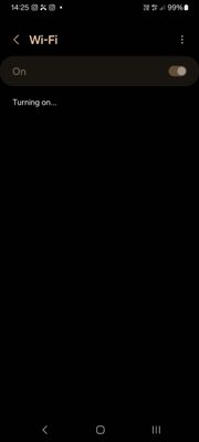

my wifi keeps dissconnecting and nothing helps i got an update on 25th of march and nothing fixes the issues i looked thru everything here and nothing works!

this makes no sence if it was an issue with the router then the WIFI icon would be glowing normaly but instead when i press the WIFI icon to connect to the it lingers between being turned on and off then it just deactivates itself.

this issue started on wednesday here all things i tried:
- turning the phone on and off with a 30min pause in between,
-turning on airplane mode ,
-resting the wifi settings,
-reseting mobile network settings,
-tinkering with the intelegent wifi settings,
-reseting the wifi router ,
-facotory reseting the phone which did allow me to turn on wifi for like 5 seconds,
also wifi turned on like 2 times completly at random but only for a second or 2. Also i probably tried other things i just cant remember them all
