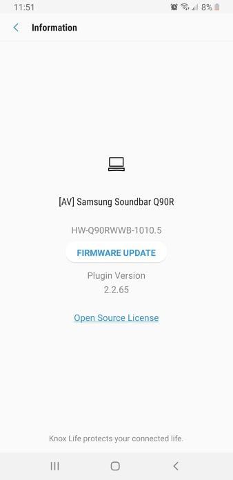

I've performed the firmware update for my HW-Q90R soundbar.
Given that there is no official statement from Samsung with the details of the update  I would like to check with the community what new features have been included.
- How can I check now the firmware version on the bar, to check if the rears are updated as well? In the past just by holding the sound mode button on the remote with the soundbar off the different versions appeared on the display.
Now it is not case. Now by holding sound mode for 5 seconds with the bar off it enables a new functionality: Test Tone
