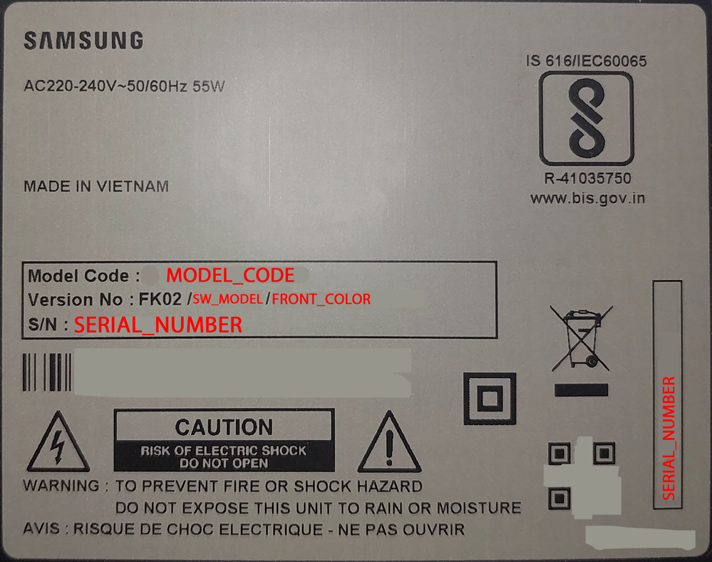

I was not even able to setup my TV, found this article and decided to go forward with it, as i didn't have a service remote i used "SmartTV RC" app from play store. used the combination "return + info + factory + menu" to enter service mode. panel info was detected autoatically, entered locale and sw model, but i forgot to add model code. I had no idea what to select from Front Color List, found a similer TV on YouTube so i copied its Value. But there was no change so after few minutes i tried again and I checked every settings and found that i had not set model code (it was set to zero) after entering that i found that S/N (Serial Number) was also not set (was showing fail). so I entered that and restarted my TV, no change.

[EDIT] If you are lucky enough you can find the Front Color on the back of you TV.
"Type" should be printed on your panel shield beside your motherboard (inside your TV)
"Local Set" is your locale, so select your country
SW Model, Model Code, S/N, Front Color can be found on the backside of your TV.
Its written like this
_____________________________________________________
| Model Code : MODEL_CODE                                                                                      |
|Version No. : VERSION_NUMBER/SW_MODEL/FRONT_COLOR               |
|S/N : SERIAL_NUMBER                                                                                                 |
|____________________________________________________|

 UTU8500N-U55TN1 is your Front Color, select it from the list.
