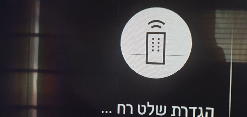

Hey,
Yesterday this line showed up
What can it be?
It has one connect box, and the tv is not under warrenty anymore.
I have this tv for about one year and half.
Thanks.

Hey @Yonisaa. Does the line appear if you perform a Picture Test? To do this, press Settings/ Menu on your remote and go to Support > Self Diagnosis > Start Picture Test. Let me know the results!

Yes, it appears in every input mode include picture test. (the first image is from the picture test)
Can it be from the one connect?
Thanks for the help.

I think it is the display, and not related to the one connect.

@CarlH  can it be related to the tcon?
It change it color a little bit by the image on the screen, see the update picture.
