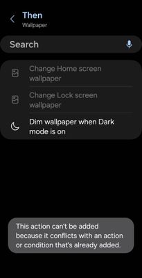

Now in routines I have a WHEN ROUTINE ENDS function that I cannot edit.
When the notification is received it doesn't change the wallpaper as it says ...
"Couldn't perform this action because another operation is preventing it"
If I try to add a new routine for another date it won't allow me to select change home screen wallpaper.
It used to just run a routine on receipt of notification and do the action, but now it seems to continue running the routine without stopping.
I am unable to edit or remove "when routine ends"
As it is performing an action from a notification it hasn't got and doesn't need an end, but I can't have a routine without and end argument ?
Now when a routine is triggered I get a notification that it is running, but without a possible end point?

 So I've deleted all the modes and routines I had set up..
If I now try to add a new routine, I still get the message..

So after deleting all my modes and routines I started again.
Without the IF notification received I can add a change to wallpaper.
But it then won't let me add the notification received...
This is completely broken!

Even with everything deleted I still get the message...
If I try to add a change wallpaper from a notification
I have disabled modes and routines, cleared cache and restarted the phone. Then re-enabled modes and routines all to no avail
