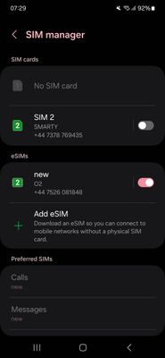

Hi there, I bought the S23 the other day and wanted to put my dual sims to work. Previously on the s21 I had the one using data and the other for calls. However I cannot activate them both. The option is grey.
I've done resets and updated my phone and to no avail it hasn't worked .
โ€ƒ
โ€ƒnow I thought it maybe positioning. With the first tray empty. I looked to see of its due to one being an E SIM and it shouldn't make a difference.
Can anyone help me please?

You are using two sims. Esim counts as one
Richmar83
Helping Hand
Handset only has 2 IMEI numbers so only 2 SIMs can be used at any time. Your eSIM is taking one IMEI, the Smarty SIM the other.
You won't be able to use 2 physical SIMs at the same time as an eSIM is applied and in use.
Chistery
Voyager
Move your physical SIM to slot 1.
ynneL
Hotshot
eSIM and SIM 2 use the same slot and can't be used together. You'll have to move SIM 2 to slot 1 then you can use them both
