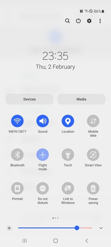

Hello everyone, last Sunday when I was staying in my phone I didn't notice the battery was low so it turned off, then I plugged in to charge, I turn it on but the Flight Mode is stuck like on/off blue faded. No service available so I can't make any calls, text or others. Still today it's the same issues tried every possible online method to fix none of them worked. Please I really need help with this, it's annoying so much when I can't call my friends or parents.

Problem solved on my Samsung S10 Lite..turn on the flight  mode by pressing and holding the faded flight mode button. Then press the  power off icon. DO not tap the RESTART button. Switch  it back on after a few seconds and then turn off the flight  mode. This has worked for me.

I don't have the solution but I find when I remove the sim card, the light goes off. But when I reinsert the sim card, it's back on again.

Same issue with me, I researched online some stuff and found out that the problem is the device not SIM. Something from the newest updates glitched in the system that made this issue or something else

Have you tried removing and reinserting your SIM card to see whether this resolves the issue and restores service to your phone?
Additionally, have you managed to Wipe the cache partition?:
https://www.samsung.com/uk/support/mobile-devices/how-do-i-clear-the-cache-on-my-device/
Please let me know when you get the opportunity to try these steps.

I have this issue too since I updated today. I've done the 2 tips you suggested but no change. No network connection, and battery discharges fast.

@fr4nk0: If you swipe up from your Home screen and head to Settings > Connections, can you toggle Flight mode on/off from here?
