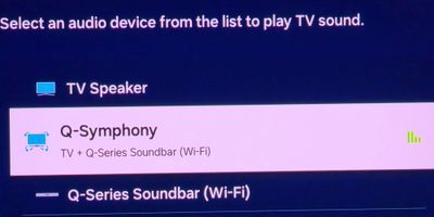

I just bought the Q990D and experienced similar issues. Over the weekend I tried various setups (with several hard resets of the soundbar) and ended up removing all the HDMI connections from/to the unit, even the ARC one, and connected it to my S95B tv set only through WiFi 5G network, channel 48 (this is a set up to be done on the WiFi router, a fritzbox 7490 in my case), avoiding all DFS channels, as this is written in the user manual.  So far it works steadily, in the coming days I will experiment by connecting the HDMI ports to verify whether the reports on other forums  about HDMI interference coming  from  other devices connected to the unit and/or TV set, have any basis.

I think in my case the system is now stable. As the WiFi only connection resulted, not always,  in no sound after switching off both tv  and soundbar, I reconnected the e-ARC HDMI cable, the one provided with the unit. After this all my  problems were solved. I did not use any other HDMI port in the soundbar as I have 3 remaining ports on my TV set. Usage of: a series x xbox, an IP tv box and a mini PC, all directly connected to the S95B tv set, did not disturb the Q-Symphony function and all sounded great. So my conclusion is that a stable WiFi connection, as described in my previous post, together with the e-ARC HDMI connection give the perfect result. I attach a photo of my tv set that shows the sound output mode.
