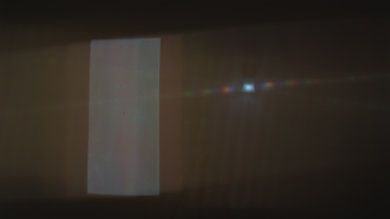

But i don't know if i'm being paranoid or something but i feel like my tv looks like it reflects everything way more than before,
Can anyone confirm that these reflections are normal for a q80 ?

Normally the easy way to spot the wide angle filter is to look at a bright light, it should be spread across your display as it diffusues the reflection, if it is just a perfect 'mirror-like' reflection, then maybe they have put the wrong panel in.
I'm sure someone will post a picture of the normal refelction soon for you, i'm looking through my phone now to see if i have any

Tom931 : looks much more reflective than mine. The concept of this TV is its lack of reflection... I would tend to think they installed you a Q60 or Q70 pannel, but I am not an expert.

I didn't have on eon my phone, but look at the rtings review image..
Does yours do that?

But it does look a bit too reflective for a q80 panel as you said...
It kinda does like the rtings pictures but it's a bit different, a bit more apparent i'd say
It probaly is just me going crazy but i'll keep an eye on it

That looks pretty reflective in comparison to mine. My TV is in my living room and it gets really bright in there when the sun is out and I get virtually zero reflections, it's actually a great feature of the television. Yours looks way more reflective. I'd give it a few more days of testing. Honestly wouldn't even know where to go from here though, like how can you prove that they replaced it with the wrong panel? It just sounds like a huge pain in the a** to me. Samsung have really outdone themselves with this whole diagonal lines issue. I don't think I'll be getting another Samsung device after I'm done with my TV. Honestly just wish I got the C9.

Thanks for your message, the reflections definitely surprised me when i saw them but yeah, don't know if i'll ever be able to prove anything. Doesn't bother me in my setup to be honest but the fact that i might have had a downgrade is irritating. Diagonal lines are gone though so that's a fair trade i guess. I'm definitely going to test that thoroughly .

To be honest I think that is quite dificult for them to replace the panel with a diferent type, for several reasons.
First the  external border between the Q60, Q70 and Q80 are diferente, also as you probably saw the panels are like a closed box, meaning that they just replace the electronic bords outside the panel, the panel arrive from fatory closed, and the models(60,70,80) have diferente caracteritics making dificult to have them compatible with each other.
