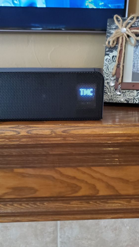

That's exactly what I'm saying. See pics. Native Netflix app showing AtmosNative Netflix app showing Atmos
Stream sending Atmos to q90rStream sending Atmos to q90r
Sending it over ARCSending it over ARC
