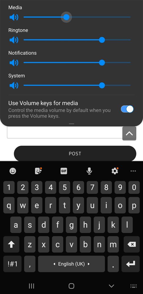

Hi, my partner's had the same problem and it's taken me a while but I've found the actual answer.
Forget DTMF settings and polishing your SIM's contacts.
1. with your dialling pad open just press the volume button ( up or down, doesn't matter ).
2. Tap the little down chevron in the top right corner of the volume bar.
3. You'll now see that your System sounds (bottom of the list on an S7) are set all the way to the left. Just slide it right and you're good to go.
Don't quite know why no one appears to know about this at Samsung but I'm an iOS fan so I'm accustomed to finding the answers myself.

I would like to point out that Samsung galaxy phone (not sure if applicable to all) has ability to set various sound/tone volume (for Media, Ringtone, Notification and System) independently from one another. You can get to that setting by pressing the volume up or down button one time till you can see the current setting of one of volume, then use your finger or pen by draging down the _ sign at tge lower middle part of the popup screen that display the volume setting. My observation is that the volume of the number dial pad tone is linked to the 'System' volume. To get dial pad tone, we need to enable the dial pad tone AND make sure the System volume is not set to 0.
Take note that any setting that silences the phone, will set the System volume to 0, thus also make the dial pad tone not audible, even if the dial pad tone is still set to enabled.
I think this is where the problem with the samsung phone dialpad tone setting lies. It should not be linked to 'System' volume, which setting is not immediately made visible to user who press the volume button but not drag down to completely expand the volume setting pop up display.
If the volume popup display is made to always all the various volume settings at once, user will sure notice quickly that the "System" volume is being silenced and can adjust it accordingly.
I think the 2 level volume setting display is completely unnecessary, but add to user confussion when using the phone.
