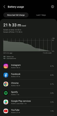

Bought my s23 ultra 256gb last march
Wqhd+, adaptive, light mode is on and protect battery is active when I am home.
I am curious as to why other users have 2 to 3 days of battery life while i only have a total of around 24 hours.
I average around 4 hours of SoT and 18 hours of Screen off time.
Hopefully someone can help me.

Oh and also, I got many apps on deep sleep and I rarely use mobile data for connecting to the internet.
GoanGeek
Samsung Members Star ★
Social media apps use lots of background data as videos are auto loaded in background .
(Maybe consider disabling this in Facebook app)
Also because of endless scrolling the screen is probably all the Time running at 120htz.
For experiment just binge on YouTube or Netflix. And you will get more SOT.
Also try to keep all setting on adaptive or auto and let the phone do its magic.
Another battery hogger is always ON location permissions .

Wqhd+ uses more battery than hd - do you need this on?
If you watch video without touching screen much, you'll get far longer battery life. It is the constant screen touching that uses most battery.
Also check which apps are using most battery. Can any be put to sleep if not used or even removed?

Thanks for your answer! I just got off an 85% charge and did a 30minute test on just watching youtube. I just lost 3% for the 30minute video and your reply makes full sense to me now.
