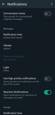

Right now, I have turned off all notifications for Whatsapp and this has enabled me to stop the announcement as well. I have played around with all the categories of notifications and have not been able to stop it. Obviously, this has completely turned off Whatsapp notifications for me, including all important notifications. But you can imagine the severity of the issue that I am ok to miss notifications rather than hearing the announcement again and again.
Attaching the screenshot.

Enable notications there and then check notifications within WhatsApp itself.

I have tried to play around with all types of combinations for notifications, hasn't worked. I have changed the notification tone within Whatsapp to change it to 'Silent', but still keep getting the same 'New Whatsapp notification received' prompt.
It fixes momentarily when I restart the phone but then the problem is back within a few hours.
For now, I am relying solely on my watch for letting me know any new notifications on Whatsapp (via the companion app on Galaxy watch)
