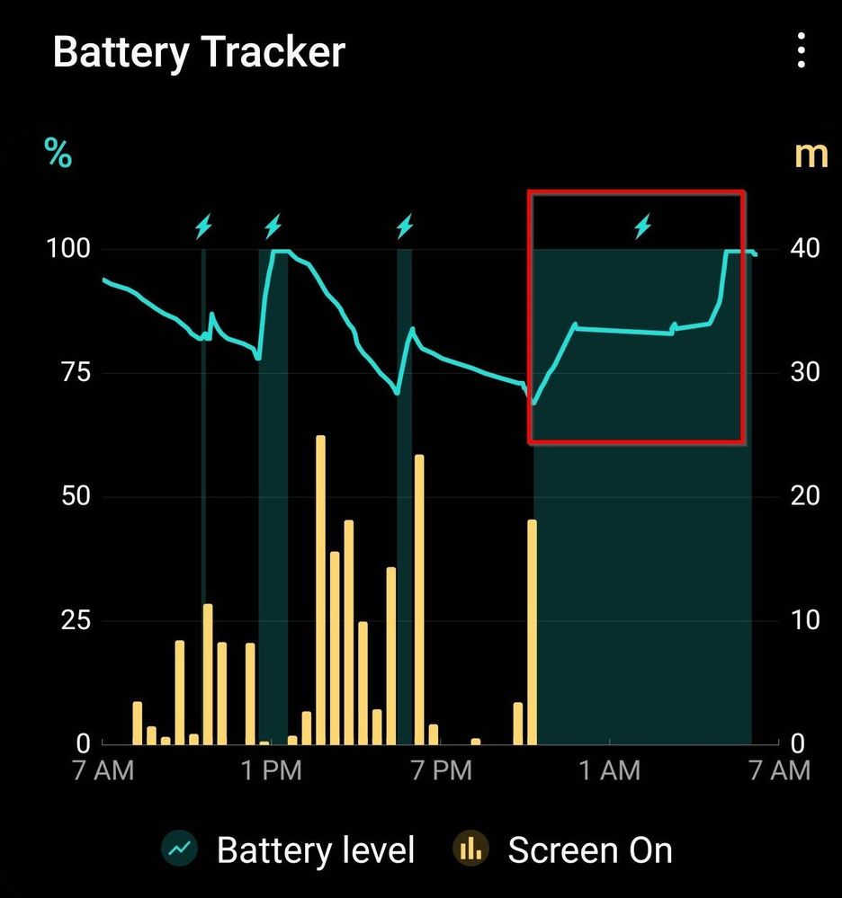

This is what the charging graph looked like tonight, Tasker was used (I didn't test Bixby, but I don't see why it wouldn't work):
As you can see, the charging stopped at 85% and only continued at the set time.

The last screenshot highlights a bit of a flaw in the protect battery system.
When phones reach 100% charge, they switch to AC power and the 'charger' becomes a power supply. The battery is only drained if the current draw of the device exceeds what the power supply can deliver. This is good because it reduces wear on the battery when connected to a power source.
During the period protect battery is active in the last screenshot we see the battery is draining. The phone is not switching to AC power mode. This means the battery is draining and the phone will top it up to keep it around 85%. Doesn't sound like a big deal, but once you crunch the numbers you see how damaging this can be.
A phone overnight will likely drain what, about 0.8-1%/hour being generous? Given the phone will reach 85% within 1-2 hours and most people sleep 7-8 hours we can say the phone will be held for 5-6 hours, so at least 5% drain will occur while the battery is being held. That is 5% of a charge cycle the battery sees. Doesn't sound big, but sound adds up.
If you keep a device for 2 years that adds an addition ~37 charge cycles to the battery. (0.05*365.25*2). If you keep it for 3 years it's over 50 additional charge cycles. That will increase battery degradation at those levels, large offsetting what 'protect battery' is even gaining you. Quite disappointing for something designed to help the battery longevity.
One addition factor is if you hold the battery at 15% and then run demanding tasks on the phone. Then the situation is /significantly/ worse if it continues to operate in the same manner.

I'm not so sure it's actually using battery while plugged in and on "protect battery".  I have run my S22+ for considerable amounts of time (months straight!) on AC power the whole time with "protect battery" on.  Every time I check the current in/out of the battery it has said 0.00 amps (not charging or depleting).
I think what the above graph might show is "open circuit voltage" which will be higher right after a battery is charged, then decline a bit as the battery sits and cools down .
