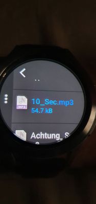

once you've tap/hold the files you what to copy , it turns blue,
and then tap the three dots on the left hand side, to copy,,tap copy ,,,
also the file go back to white
then scroll to ringtone folder, tap open it ,,
it will be the same as the pic, no name just a   < ...     to show you are in the ringtone folder,,,
as in the pic i did for you early in the post, then tap the blue tick to paste in the ringtone folder,,
and the file name will be whatever you tap/hold that turned blue... mine show's " 10_sec.mp3 "
if you have done it like i've said it should be there,,,
you may/will have restart your watch for them to show up in the sounds list that you want to changed it too,, as many other have said that it needs to be done
i hope you can understand this as i just did it on my watch step by step, so this is right for you,,
good luck👌🤞🤞4you
one question are you copying -- " mp3 " and " ogg ",, as these are the only files that i know that work,, as other have confirmed to me

it should look like this
when you hold the file it looks like this and then do the above

sjj67
Navigator
you are missing out the step to copy as it is showen on your watch -- select all and not copy,,
that is where you are going wrong
once you've tap/hold the files you what to copy , it turns blue,,, ==
-------  you are not getting it to turn blue-------- as in 2nd pic2nd pic
and then tap the three dots on the left hand side, to copy, 2nd pic
" 2nd pic ",tap copy ,,, as in  1st pic above
and then tap the tick to paste them in the ringtone folder ---- in the 1st post to you
blue file.jpg  this is high-light it to copy
copy.jpg      this is to copy it
The_Tick_is_Blue.jpg  this is to paste it in the ringtone folder
