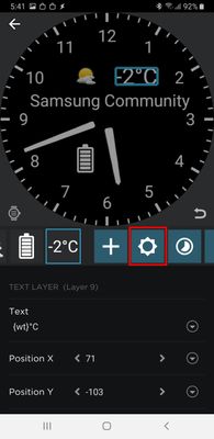

Screenshot_20190129-053914_WatchMaker.jpgTextScreenshot_20190129-053929_WatchMaker.jpgWrite somethingScreenshot_20190129-053936_WatchMaker.jpgText with default  valueScreenshot_20190129-053942_WatchMaker.jpgCurrent temperatureScreenshot_20190129-053955_WatchMaker.jpgWhere is it?Screenshot_20190129-054008_WatchMaker.jpgStill nothing?Screenshot_20190129-054013_WatchMaker.jpgGo to settingsScreenshot_20190129-054017_WatchMaker.jpgWeaherScreenshot_20190129-054021_WatchMaker.jpgGPSScreenshot_20190129-054030_WatchMaker.jpgOpenWeatherMapScreenshot_20190129-054052_WatchMaker.jpgPreviewScreenshot_20190129-054113_WatchMaker.jpgAdd units
  1. Add a text box
  2. Write anything. Note: I did not figure out how to invoke the editor of variables directly.
  3. In the editor, go to the Text property
  4. Select Current Temperature in the Weather section {wt}
  5. An empty element is displayed!
  6. Leave the editor
  7. Go to Settings
  8. Here select Weather, the menu will be displayed if you want to use manual positioning or GPS
  9. Then change weather providers. This is because Yahoo does not work when this article was written.
  10. Go to preview, there is a number!
  11. Because the number itself is ugly, add units.

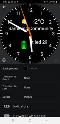

Let's play on. Battery icon is boring white, change to red using Tint:
Red is less boring, but the color might tell us something useful. Maybe the charge level.
Go back to the Tint property, click the text with the hexadecimal color expression and enter this command:
{bl}> 95 and 'ffffff' or 'ff0000'
This is what we say: if the condition that the charge level is above 95% is met, use the first value, otherwise use the second one.
Screenshot_20190129-054550_WatchMaker.jpgScreenshot_20190129-054600_WatchMaker.jpgScreenshot_20190129-054604_WatchMaker.jpg
Since the charge level was "only" 91%, the battery is red. You can try to use different thresholds to see that it really works.
Two colors are still boring....
{bl}> 85 and '00ff00' or {bl}> 30 and 'ffffff' or 'ff0000'
If the battery is above 85%, use green (R G B), if not more than 30%, use white, otherwise red. So 0-30% will be red, 31-85% white and over 85% green.

What if we wanted the color to change with the actual temperature when we click on it? (I believe you will be able to handle the color based on the temperature yourself.)
Now it will be a little more complicated. Press icon of watch in the left down corner. Summary of watchface appears. Go down and select Script and write a simple line here:
var_mode = 1
This is how we have created a variable that tells us what mode we are using. The default will be 1.
Let's go to the text layer with the temperature and change the Color property:
var_mode == 1 and '00ff00' or 'ff0000'
Thus we say: if var_mode is equal to one, use green, otherwise red.
Now we have to make the var_mode change when we click on the temperature. Go into the Tap action and select Run Script:
Screenshot_20190129-055021_WatchMaker.jpgScreenshot_20190129-055025_WatchMaker.jpgScreenshot_20190129-055107_WatchMaker.jpg
the command for the script is:
var_mode = var_mode == 1 and 2 or 1
Thus we say that if mode 1 is to change to 2, otherwise to 1. This will ensure that these two values ​​will continually change.
Now we can test that the color of text with temperature changes when we click on it.
