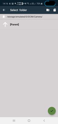

Select the remote folder on OneDrive and the local folder (photo folder).
Screenshot_20191209-141535_FolderSync Pro.jpg   Screenshot_20191209-141550_FolderSync Pro.jpg  Screenshot_20191209-141627_FolderSync Pro.jpg  Screenshot_20191209-141636_FolderSync Pro.jpg
Enable scheduled sync. For example, we choose Daily , but we can set a lot of detailed rules. The section with conflicts is important, here we set how to act. Backup can be limited to WiFi networks only.
