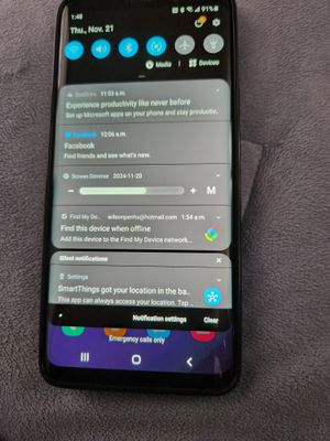

I fixed it by doing the following:
1st with very difficult step to turn low or very high brightness
2nd install screen dimmer which takes control of the brightness and fix the green lines and black screen
3rd use screen dimmer to increase/decrease brightness
Now an unuseable phone is back to life
I also saw that simple procedure of remove and put back the screen flat cable fix the issue,
It seems issues with old s9
Good luck

Thanks, but the instructions are unclear. What screen dimmer are you using and what does "1st with very difficult step to turn low or very high brightness" mean?
wilsonpenha
Apprentice
Hey sorry
The hard part was to find the brightness bar to be able to set it to low to be able to see the screen and then install the screen dimmer - reduce flicker from REWHEX and fix the issue
