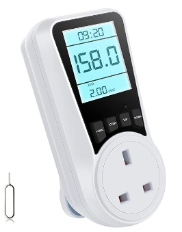

2 ways you can try see if the heater is working OK :
1st is if you have one of these plug in energy meters and you have easy access to the washing machine plug and monitor through the wash and see if the wattage goes up when it gets to the stage in the wash where the heater turns on .
