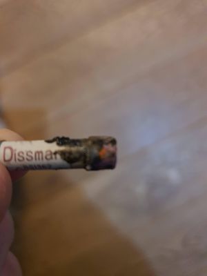

Hello,
I've seen a few reports of people having issues with Eco bubble washing machines cutting out or not powering on.
Ours failed during a cycle and then the next day no power. Whilst waiting for the repair engineer over a few days our electric tripped. Thought nothing of it until removing the washing machine ready for the repair.
The plug smelt funny and on closer inspection the fuse had melted and scorched the socket.
This machine is just under 5 years old. I find it strange that some of the questions on the phone during the technical quiz of the problem related to scorch marks around the plug socket. The engineer arrived and replaced the electric cable and also blown controller board..... handy having the spares already on the van.
Have Samsung a problem with boards and electrics in these machines???? Will we see a pattern in the next few years and see a denial of issues like the Hotpoint fires??

Hi - exactly the same problem here with the WF805FE. The machine is just over 7 years old. The problems started when the machine would stop after a few minutes into any of the washing cycles. We managed to find settings that would enable us to get some washing done and it seemed to be ok. When we tried it a couple of days ago we couldn't get it to turn on. I've now had a chance to investigate further at the weekend and the fuse has blown and taken out the extension cable (the power leads on these machines are too short). The fact we can't get it to start with a new fuse presumably means the fuse board has blown. I could post a photo of the burnt out fuse and plug, but it looks just like all the others on the site.
