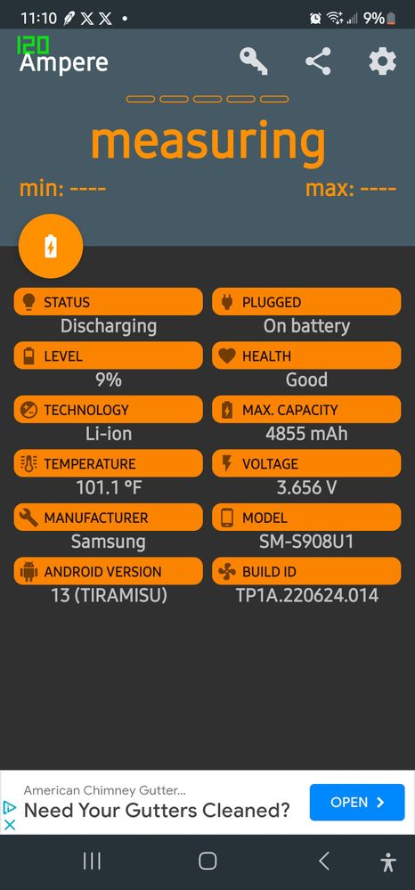

thehappiestdad
First Poster
My S22Ultra decided today that it will no longer charge with a cable. I can plug a cable in from the wall outlet and for about 15 seconds, it charges with fast charging speed, then it goes to regular charging for about 15 seconds and last it stops charging. I downloaded 2 battery applications and took screen shots. It only works on a wireless charger now. Screenshot_20230804_111035_Ampere.jpgScreenshot_20230804_111055_Ampere.jpgScreenshot_20230804_111106_Ampere.jpg

I have tried multiple chargers, multiple USB cables but no luck. I have had 9 Galaxy phones since the Galaxy S3 was released and I have never seen anything like this before.
