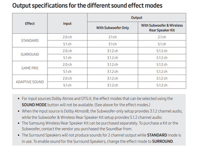

Dolby Atmos only works with eARC connection and I recommend having both the subwoover and rear-speakerset. Also with SURROUND-effect mode selected.
Without the rear-speakerset, the max channel output you can have is 3.1.2ch.
