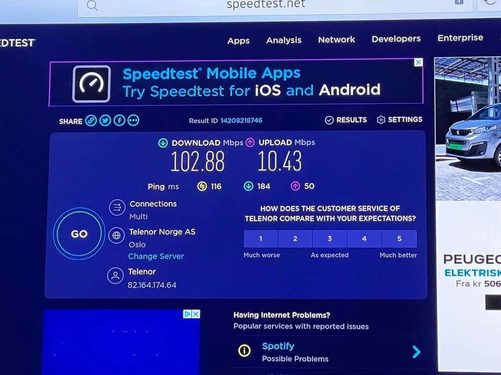

Just a small update: Everything seems to still be working well. To me it seems the problem was in the WiFi network or internet connection. I did another test yesterday and the TV's own internet browser did 102.88 Mbps in Downloads, and 10.43 Mbps in Uploads. So no issues with the playing 4K60Hz in the TV's own YouTube app.
By the way, I am not so familiar with the Ping, so can anyone tell me if the "116", "184" and "50" is good in this speed test ? I think this has to do with how stabile the internet connection to my TV and other WiFi connected devices operate with connection to the internet. I still have some delays in the miniature pictures of each photo - both in the YouTube "newsfeed", my subscription videos, etc. I also sometimes experience that movies and TV-shows on the HBO Max and Play TV2 app stops - and maybe it has to do with the "ping" or WiFi-/internet connection... I know I should try out using a cable connected internet, but I wanted to learn more about things and issues. I do not want to buy an Apple TV or Chromecast device for these things yet, as I have been hoping they will release an 8K version, which they have not yet (only 4K).
