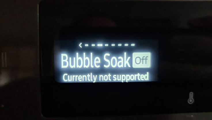

WilliamUlsterman
First Poster
i have the low detergent warning which went away but the bubble soak function is still not available under any cycle chosen 2 months later. This function is in the system menu and has never been available to turn on! this is incredibly frustrating.bubblesoakissue.JPG.
Paul_HL
Samsung Pro
HI , when you cay went away did you ok the message ?
also what cycle are you trying to use ?
