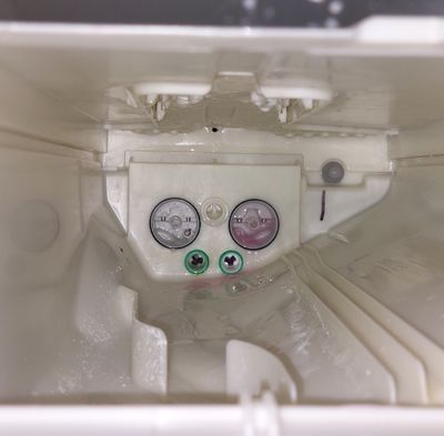

Hi all, got similar issue. We got a WW90T684DLN/S1.
First time we had engineer around and changed the pump. Then it worked. Now it feels like it doesn't work again, laundry doesn't smell soapy fresh. There is still soap liquid inside the autodose tray, not really full level but we don't get a message either saying it's low level.
We don't use the fabric softener side.
Everyone here writes about the softener side mostly, but is it the same issue with the soap dispenser pump?
I've attached a picture of the pump side, it looks pretty clean still and the replacement pump was only done 3 months ago.
Can anyone tell me what the lower 2 circles with the green seals are and do? The bigger grey circles I believe are the dispense pump sockets?

Hi, sorry to hear you are having problems with Autodose too. My problem was on the fabric softener side, as the fabric softener was damaging the seal within the pump (you can’t see the seal looking into the drawer space, you have to take the actual pump off by removing the top of the washing machine) then you will see an oblong rubber seal. It all depends on the detergent, but like you say, most don’t have a problem on the detergent side, just the softener side.
i bought my machine in September 2020 and had a new pump fitted by Samsung in November 2021. Since then, everything has been good with very frequent use, suggesting they upgraded the seal material.
Nothing to suggest your new pump hasn’t gone faulty though. If it’s only 3 months old, is it still covered by warranty?
