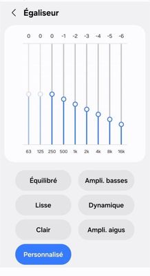

• I tested all the built-in equalizer profiles, including the “Soft” mode, but none offered a balanced enough output to avoid harsh peaks. I even tried customizing the equalizer manually.
(See screenshot:)
