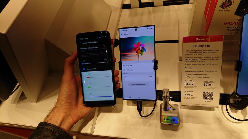

so i've come to a very scary conclusion, i tested my dads old galaxy s9+ to really get a feel of the colors and the brightness, it has no tint what so ever the colors are perfectly cold compared to the yellow galaxy fold white is whiter on the s9+, and the fold was better than the note 10+ so if the note 10+ had a screen like the s9+ i would have been happy how is this normal how is this ok? how is it not embarassing that a newer model is positively worse than an old one how is it not a joke that i am saying that i'd prefer the note 10+ to have a several generations older display? because that display on the s9+ is actually really good, i was surprised once i made it colder and increased to max brightness.
i don't know what samsung did with newer models but i call it false advertising they are considerably worse than the older ones when it comes to display quality.

i thought this was an interesting revelation, here is the note 10+ on display in a store i set it to natural, and here it is next to my dads s9+DSC_0101.JPGDSC_0090.JPG
