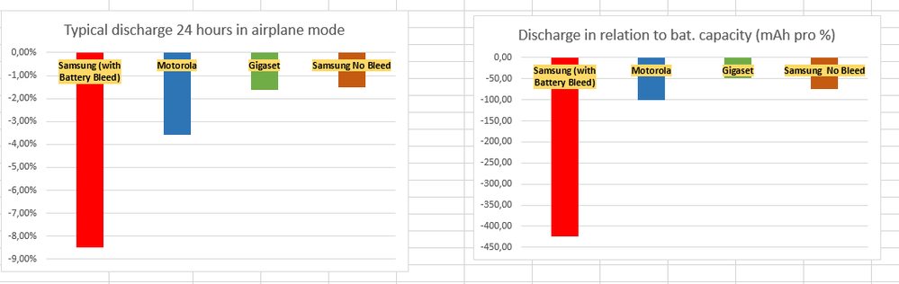

I would also like to show again graphically how the problem manifests itself, especially in comparison to other devices. During the holidays I had time to compare a few smartphones directly and to document again what I had observed with smartphones over the years and because the problem with the A14 is not/should not be normal. What can also be clearly see in my opinion, is that the A14 behaves completely normally and even very well WITHOUT bleed.
As comparison:
-Motorola Moto E4 (6.5 years old, deep discharge several times, 2800 mAh battery)
-Gigaset GS110 (>4 years old, not the best phone, also some issues, 3000 mAh)
-Samsung Galaxy A14 (with battery bleed)
-Samsung Galaxy A14 (without battery bleed)
Attached are two diagrams and the raw data
