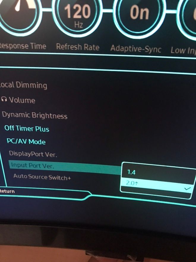

Hi, maybe someone know that issue?
Monitor Samsung G8 NEO 32' Monitor, full model name: LS32BG850NPXEN , firmware version is: M-B853GGZA-1007.0 ,
So situation is next on PS5 don't support VVR. Also on monitor Input signal HDMI available is 1.4 or 2.0(arrow up), so in menu no available stay HDMI 2.1 .

Hi, are you using a hdmi 2.1 cable?
Crimea
Student
Yeah I use default HDMI cable from PS5, as I know it's should be 2.1 HDMI.
Rippers
Pioneer
OK, I am using a hmd2.1 for my pc and mine also says 2.0 arrow up. I am getting max resolution and 240hz with the cable. All working as it should.

In my experience that is false. I'm using neo g8 with my ps5 with vrr on and it still show 'adaptive sync' in the menu. I had also problem with turning vrr on and for me solution was to set refresh rate to 120hz, if you set it on 240hz it won't work.
Btw. the ps5 hdmi cable is 100% compatible and the arrow up means 2.0 and higher, so that include 2.1 as well.
