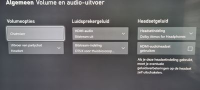

 xbox (microsoft is aware) finally. Now hope they van fix there side of the case.. samsung should fix the auto function earc delays etc. But atleast  whe now know that there are people trying to fix things. Whe all have payed alot of money for a futureproof entertainment center... samsung and microsoft should have better support in the future.
