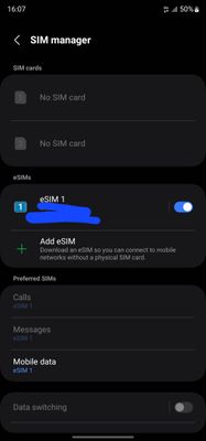

Settings>connections>SIM manager. Could you possibly screenshot that page (blank out any personal details ie phone number). You don't say if you also have a physical SIM as this may cause interruption if you're using as dual SIM. S23 Is only dual SIM passive so can only use one SIM at a time.

That looks fine. Reach out to your network provider and check for any network issues in your area. They can also go through any troubleshooting in case the eSIM needs attention.
