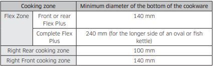

Has the hob ever work well? If the answer is yes, i think the installation was ok, so you should check for pots and pans.
These ones should have the correct dimension and have to adhere perfectly.
The induction cooking zones automatically adapt to the size of the bottom of the pot up to a certain diameter. However, the magnetic base of the bottom of the cookware must have a minimum diameter based on the size of the cooking zone.
I suggest you to verify the pans correct position, too:
For more information, please, check the user manual or call our Customer Service.
