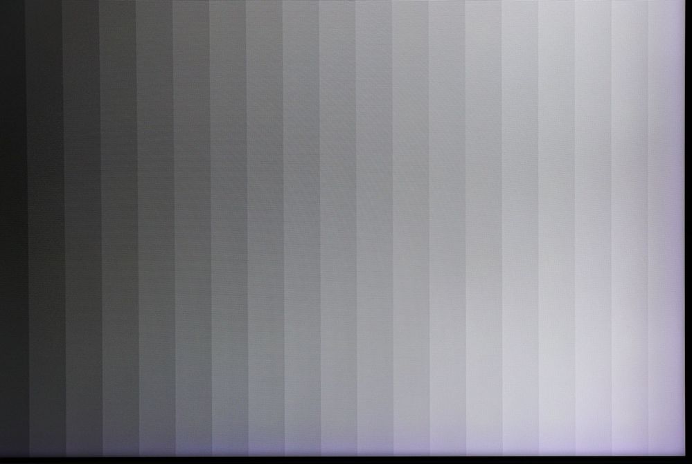

model has had such tinted borders. First I was skeptical about the bad news from my TV dealer but after checking the Q90R and Q80R in his showroom especially regarding the borders I had to confirm his opinion.
But there was a little difference between both models. The Q90R showed more harder borders and the Q80R
softer and wider borders, which vary depending on the viewing angle. I’m not from the technical side but I think,
the problem has something to do with the Direct Full Array Panel in connection with the new Anti-reflection Layer.
If you want to reproduce the tinted borders use the b/w test pictures of the TV or activate the Ambient Mode with the Gallery feature and switch off the 3D Shadow Border Function. Then you can see the problem very clear.
Btw I have found only one source which stated the border problem in his product tests. On the test page of the Q90R from RTINGS.com you can read concerning the gray uniformity: “When the TV is displaying gray content, like older black and white movies, some people might notice a slight blue tint at the edges.”
Unfortunately the purple/blue tint on our TV was visible along the full borders and also under nearly all viewing conditions.
Anyhow the result is completely inacceptable in my eyes, especially for a high priced premium TV range from Samsung.
In your case I would try a repair from Samsung. Maybe they can improve the situation a bit with a new panel.
To be honest, I would not give too much hope for a perfect solution. That’s why I returned the device and will wait for the next years generation.
I will add some photos of our Q90R:Samsung65Q90R_Border1.jpgSamsung65Q90R_Border2.jpgSamsung65Q90R_Border3.jpgSamsung65Q90R_Border7.jpgSamsung65Q90R_Border8.jpgSamsung65Q90R_Border9.jpg
