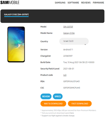

I've downloaded the correct firmware from Sammobile:
and followed the instructions: https://www.sammobile.com/wp-content/themes/sammobile-6/assets/static/instructions-fw-5file.pdf
During flash on Odin3 v3.14, process get stuck at "recovery.img"
with no process bar shown on phone's screen. Next four lines happen when I exit "Download Mode".
Tried different USB port, different cable, one prior firmware version (July 2021 release instead of Sep 2021) etc. Many times, same results.
BTW, "Download Mode" model (product name) and "about phone" model number are different: SM-G970N on "Download Mode" upper left corner of the screen, SM-G970F on "about phone" model number. Could it be that I've downloaded the wrong firmware (one shown under "about" menu)?
