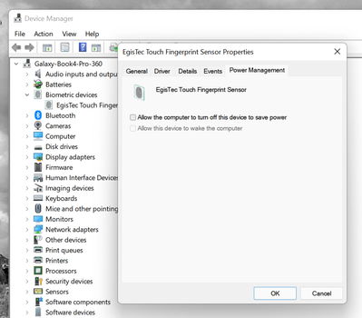

I've tried turning this power management setting off, to see if that makes a difference.
Update...nope, still fails with the Power Management turned off.
